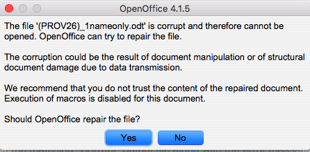

All is good except trying to use an ODT template to generate a contract. The azur template works fine, but I’d like to use a my own template, use Dolibarr to enter data in fileds and create a PDF. I’ve tested using my own template, the default templates and all combinations. Each time Dolibarr generates an ODT template, not a pdf. All of these generated ODT file are seen as corrupt and not repairable by OpenOffice 4.1.5.
Yet if I rename the output file to *.zip and unzip it, the file “content.xml” contains the correct information. It seems that Dolibarr can insert the correct information in the ODT template and create a new document, but there is something else going on which corrupts the new document/output file.
Attached is a very simple, one field, input template (1nameonly.odt) and the matching “Corrupt” output file ((PROV26)_1nameonly.odt) along with the error message (screenshot). If anyone could help that would be fantastic, I’m going out of my mind!
